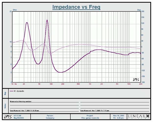

spido Posted 22 augustus 2008 Report Share Posted 22 augustus 2008 (...) Dynaudio's staan niet bekend dat ze een grillig impedantieverloop hebben (...) impedantie vs. frequentie, Dynaudio 52-SE http://www.audioholics.com/reviews/speaker...view_fullscreen Beste Arjen, Wat niet weet, wat niet deert... Link to comment Share on other sites More sharing options...
Erikatn Posted 23 augustus 2008 Report Share Posted 23 augustus 2008 The 1.3 Mk.II's impedance is shown in fig.1. The minimum value is 3.43 ohms at 177Hz, with a moderate electrical phase angle above that frequency. The saddle at 43Hz in the magnitude trace indicates the tuning of the port, while the combination of 5.3 ohms impedance and a 42 degrees phase angle at 90Hz implies that a good 4 ohm-rated amplifier would work best with this speaker. Goed aansturen dus. Confidence C1 Dit oogt vlakker. Link to comment Share on other sites More sharing options...
