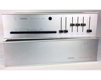

spido Posted 2 augustus 2014 Report Share Posted 2 augustus 2014 (...) These are a used, RADFORD SC 242, Pre Amplifier and SPA 60, Stereo Power Amplifier, from 1969. 100% original and 100% fully working, amazing sound. Only some letters and indicator level are missing with the age.(...) http://www.ebay.co.uk/itm/RADFORD-SC-242-SPA-60-PRE-AMP-STEREO-POWER-AMP-USED-/251493859800?pt=UK_AudioTVElectronics_HomeAudioHiFi_Amplifiers&hash=item3a8e33c1d8 Voor wie toevallig nog op zoek was naar een prachtige vintage versterkercombinatie... Link to comment Share on other sites More sharing options...
